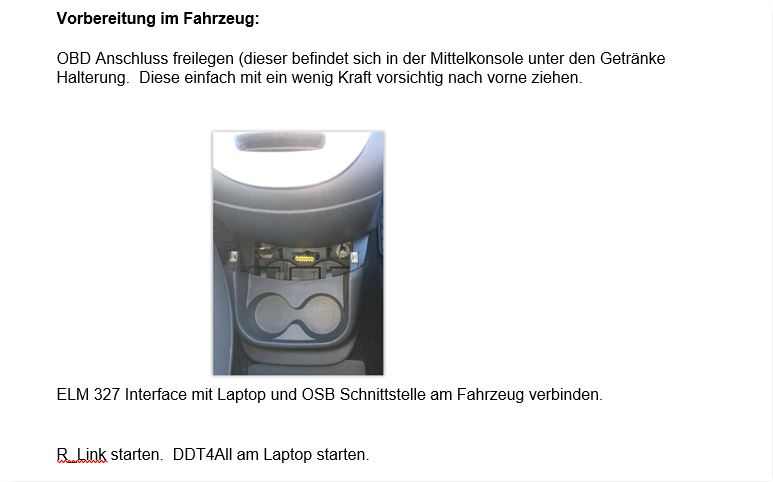

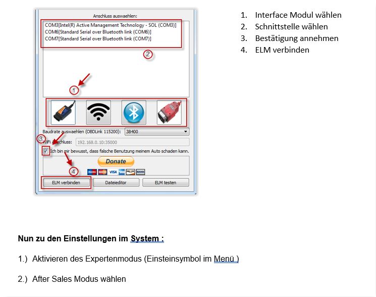

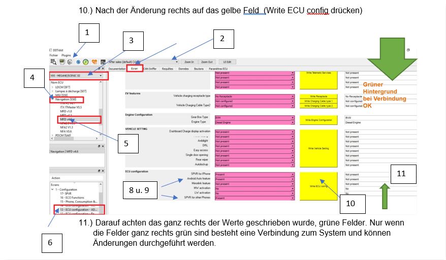

Hallo konnte den Text nur als Bilder einfügen pdf ging nicht.
ext/dmzx/imageupload/img-files//24592/1 ... 52c82d.jpgext/dmzx/imageupload/img-files//24592/6 ... 19cc69.jpg
ext/dmzx/imageupload/img-files//24592/9 ... bc72e1.jpgext/dmzx/imageupload/img-files//24592/e ... 0afc53.jpgext/dmzx/imageupload/img-files//24592/b ... 2d029a.jpgext/dmzx/imageupload/img-files//24592/c ... def53a.jpgext/dmzx/imageupload/img-files//24592/2 ... 2b1e9c.jpgext/dmzx/imageupload/img-files//24592/5 ... 5f3104.jpgext/dmzx/imageupload/img-files//24592/d ... 7df24e.jpg
